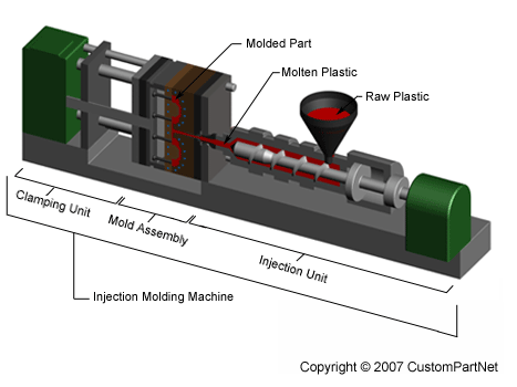

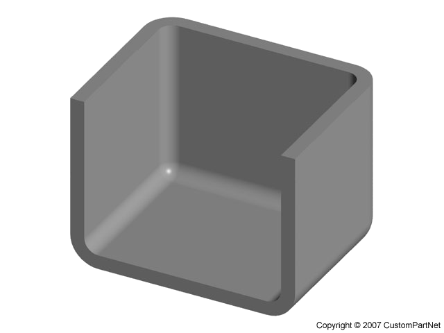

Injection molding is the most commonly used manufacturing process for the fabrication of plastic parts. A wide variety of products are manufactured using injection molding, which vary greatly in their size, complexity, and application. The injection molding process requires the use of an injection molding machine, raw plastic material, and a mold. The plastic is melted in the injection molding machine and then injected into the mold, where it cools and solidifies into the final part.
Injection molding machine overview
Injection molding overview
Injection molding is used to produce thin-walled plastic parts for a wide variety of applications, one of the most common being plastic housings. Plastic housing is a thin-walled enclosure, often requiring many ribs and bosses on the interior. These housings are used in a variety of products including household appliances, consumer electronics, power tools, and as automotive dashboards. Other common injection molded parts include different types of open containers, such as buckets and other containers.
The process cycle time for injection molding is very short, typically between 2 seconds and 2 minutes, and consists of the following four stages:

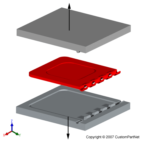

  1. Clamping - Prior to the injection of the material into the mold, the two halves of the mold must first be securely closed by the clamping unit. Each die half is first cleaned from the previous injection and then lubricated to facilitate the ejection of the next part. The time required to open and close the mold is dependent upon the machine - larger machines (those with greater clamping forces) take longer to open and close. Also, if the mold is not held closed with sufficient force during injection, the plastic being injected may force the mold open, causing flash on the part. This time can be estimated from the dry cycle time of the machine.
  2. Injection - The raw plastic material, usually in the form of pellets, is fed into the injection molding machine, and advanced towards the mold by the injection unit. During this process, the material is melted by heat and pressure. The molten plastic is then injected into the mold very quickly and the buildup of pressure packs and holds the material. The amount of material that is injected is referred to as the shot. The injection time is difficult to calculate accurately due to the complex and changing flow of the molten plastic into the mold. However, the injection time may be estimated by the shot volume, injection pressure, and the power of the injection unit.
  3. Cooling - The molten plastic that is inside the mold begins to cool as soon as it makes contact with the interior mold surfaces. As the plastic cools, it will solidify into the shape of the desired part. However, during cooling some shrinkage of the part may occur. The packing that occurred during injection compensates for some of this shrinkage. The mold can not be opened until the required cooling time has elapsed. The cooling time can be estimated from several thermodynamic properties of the plastic and the maximum wall thickness of the part.
  4. Ejection - After the required cooling time has passed, the mold halves can be opened and an ejection system is actuated to release the part. The time that is required to open the mold and eject the part can be estimated from the dry cycle time of the machine and should include any time required to ensure that the part is free of the mold. The ejection system must apply some force to eject the part, because during cooling the part shrinks and adheres to the mold. Too little ejection force and the part will be stuck in the mold, while too much ejection force may damage or deform the part. The ejection force required is determined by the ejection pressure, the area of the part being ejected, and the number of ejection pins being used.

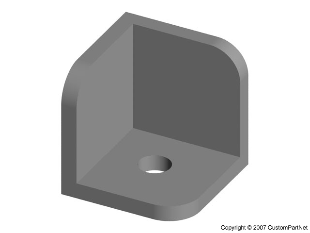

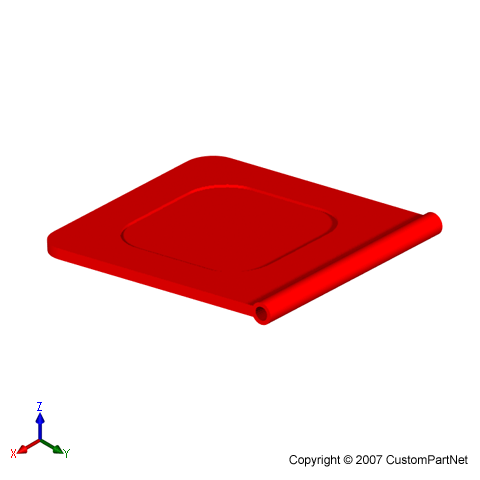

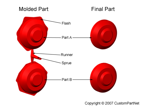

After the injection molding cycle, some post processing is typically required. During cooling, the material in the runners of the mold will solidify attached to the part. This excess material, along with any flash that has occurred, must be trimmed from the part, typically by using cutters. For some types of material, such as thermoplastics, the scrap material that results from this trimming can be recycled by being placed into a plastic grinder, also called regrind machines or granulators, which regrinds the scrap material into pellets. Due to some degradation of the material properties, the regrind must be mixed with raw material in the proper regrind ratio to be reused in the injection molding process.
Injection molded part

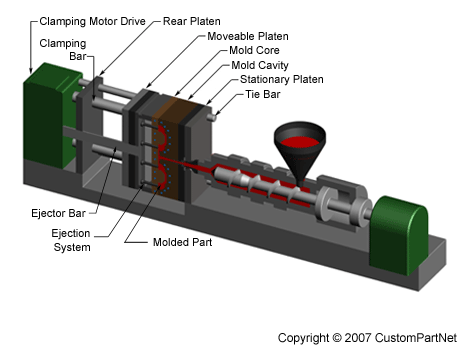

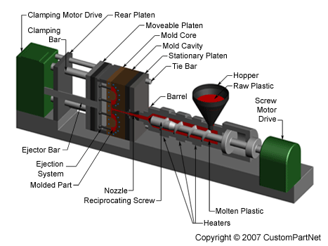

Injection molding machines have many components and are available in different configurations, including a horizontal configuration and a vertical configuration. However, regardless of their design, all injection molding machines utilize a power source, injection unit, mold assembly, and clamping unit to perform the four stages of the process cycle.

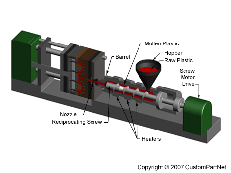

Injection unit
The injection unit is responsible for both heating and injecting the material into the mold. The first part of this unit is the hopper, a large container into which the raw plastic is poured. The hopper has an open bottom, which allows the material to feed into the barrel. The barrel contains the mechanism for heating and injecting the material into the mold. This mechanism is usually a ram injector or a reciprocating screw. A ram injector forces the material forward through a heated section with a ram or plunger that is usually hydraulically powered. Today, the more common technique is the use of a reciprocating screw. A reciprocating screw moves the material forward by both rotating and sliding axially, being powered by either a hydraulic or electric motor. The material enters the grooves of the screw from the hopper and is advanced towards the mold as the screw rotates. While it is advanced, the material is melted by pressure, friction, and additional heaters that surround the reciprocating screw. The molten plastic is then injected very quickly into the mold through the nozzle at the end of the barrel by the buildup of pressure and the forward action of the screw. This increasing pressure allows the material to be packed and forcibly held in the mold. Once the material has solidified inside the mold, the screw can retract and fill with more material for the next shot.
Injection molding machine injection unit
Injection molding machine - Injection unit
Clamping unit
Prior to the injection of the molten plastic into the mold, the two halves of the mold must first be securely closed by the clamping unit. When the mold is attached to the injection molding machine, each half is fixed to a large plate, called a platen. The front half of the mold, called the mold cavity, is mounted to a stationary platen and aligns with the nozzle of the injection unit. The rear half of the mold, called the mold core, is mounted to a movable platen, which slides along the tie bars. The hydraulically powered clamping motor actuates clamping bars that push the moveable platen towards the stationary platen and exert sufficient force to keep the mold securely closed while the material is injected and subsequently cools. After the required cooling time, the mold is then opened by the clamping motor. An ejection system, which is attached to the rear half of the mold, is actuated by the ejector bar and pushes the solidified part out of the open cavity.
Injection molding machine clamping unit
Injection molding machine - Clamping unit

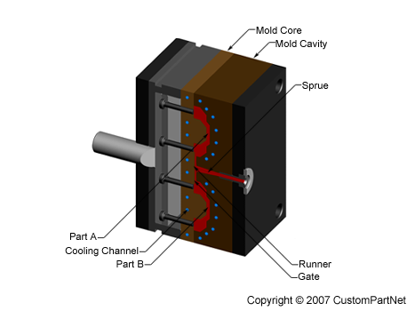

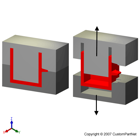

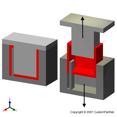

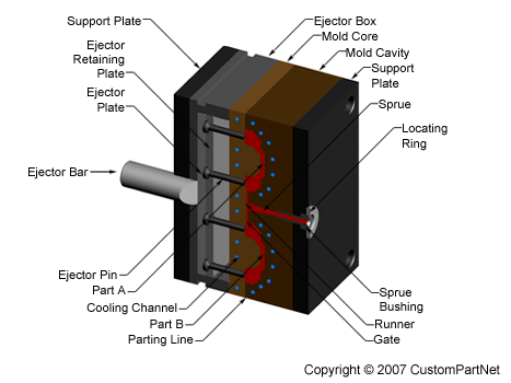

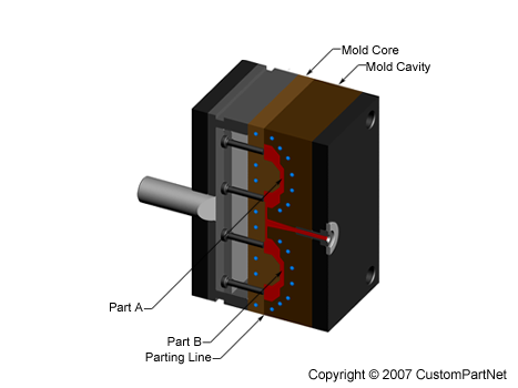

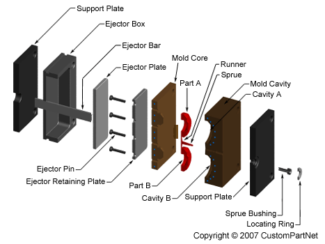

The injection molding process uses molds, typically made of steel or aluminum, as the custom tooling. The mold has many components, but can be split into two halves. Each half is attached inside the injection molding machine and the rear half is allowed to slide so that the mold can be opened and closed along the mold's parting line. The two main components of the mold are the mold core and the mold cavity. When the mold is closed, the space between the mold core and the mold cavity forms the part cavity, that will be filled with molten plastic to create the desired part. Multiple-cavity molds are sometimes used, in which the two mold halves form several identical part cavities.
Injection molding mold overview
Mold overview
Mold base
The mold core and mold cavity are each mounted to the mold base, which is then fixed to the platens inside the injection molding machine. The front half of the mold base includes a support plate, to which the mold cavity is attached, the sprue bushing, into which the material will flow from the nozzle, and a locating ring, in order to align the mold base with the nozzle. The rear half of the mold base includes the ejection system, to which the mold core is attached, and a support plate. When the clamping unit separates the mold halves, the ejector bar actuates the ejection system. The ejector bar pushes the ejector plate forward inside the ejector box, which in turn pushes the ejector pins into the molded part. The ejector pins push the solidified part out of the open mold cavity.
Injection molding mold base
Mold base

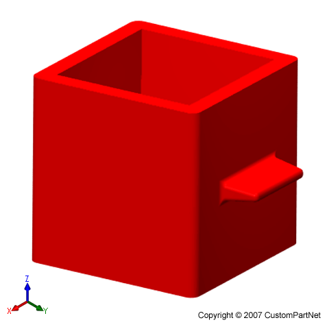

Mold channels
In order for the molten plastic to flow into the mold cavities, several channels are integrated into the mold design. First, the molten plastic enters the mold through the sprue. Additional channels, called runners, carry the molten plastic from the sprue to all of the cavities that must be filled. At the end of each runners, the molten plastic enters the cavity through a gate which directs the flow. The molten plastic that solidifies inside these runners is attached to the part and must be separated after the part has been ejected from the mold. However, sometimes hot runners systems are used which independently heat the channels, allowing the contained material to be melted and detached from the part. Another type of channel that is built into the mold is cooling channels. These channels allow water to flow through the mold walls, adjacent to the cavity, and cool the molten plastic.
Injection molding mold channels
Mold channels

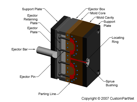

Mold design
In addition to runners and gates, there are many other design issues that must be considered in the design of the molds. Firstly, the mold must allow the molten plastic to flow easily into all of the cavities. Equally important is the removal of the solidified part from the mold, so a draft angle must be applied to the mold walls. The design of the mold must also accommodate any complex features on the part, such as undercuts or threads, which will require additional mold pieces. Most of these devices slide into the part cavity through the side of the mold, and are therefore known as slides, or side-actions. The most common type of side-action is a side-core which enables an external undercut to be molded. Other devices enter through the end of the mold along the parting direction, such as internal core lifters, which can form an internal undercut. To mold threads into the part, an unscrewing device is needed, which can rotate out of the mold after the threads have been formed.
Mold - Closed
Injection molding mold exploded view
Mold - Exploded view

DefectCauses
Flash
  • Injection pressure too high
  • Clamp force too low
Warping
  • Non-uniform cooling rate
Bubbles
  • Injection temperature too high
  • Too much moisture in material
Unfilled sections
  • Insufficient shot volume
  • Flow rate of material too low
Sink marks
  • Injection pressure too low
Ejector marks
  • Cooling time too short
  • Ejection force too high
Many of the above defects are caused by a non-uniform cooling rate. A variation in the cooling rate can be caused by non-uniform wall thickness or non-uniform mold temperature.

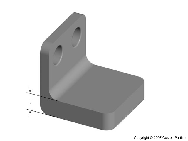

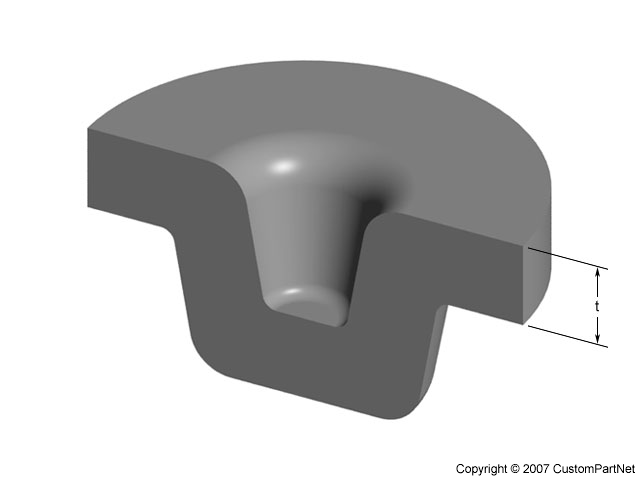

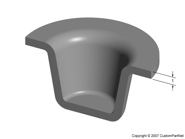

Maximum wall thickness
  • Decrease the maximum wall thickness of a part to shorten the cycle time (injection time and cooling time specifically) and reduce the part volume
  • Uniform wall thickness will ensure uniform cooling and reduce defects
Part with thick walls
INCORRECT
Part redesigned with thin walls
CORRECT

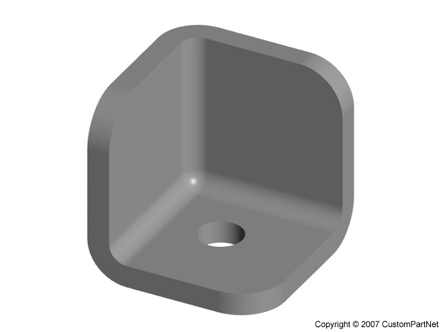

Corners
  • Round corners to reduce stress concentrations and fracture
  • Inner radius should be at least the thickness of the walls
Sharp corner
INCORRECT
Sharp corner
Rounded corner
CORRECT
Rounded corner

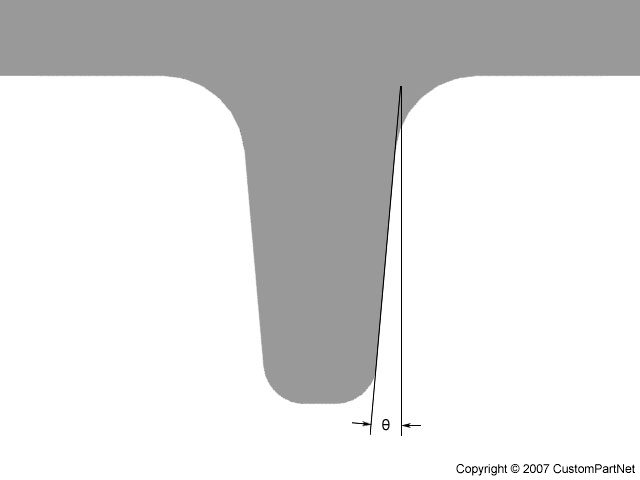

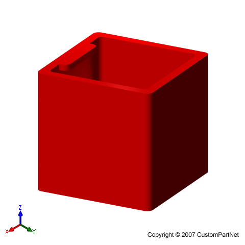

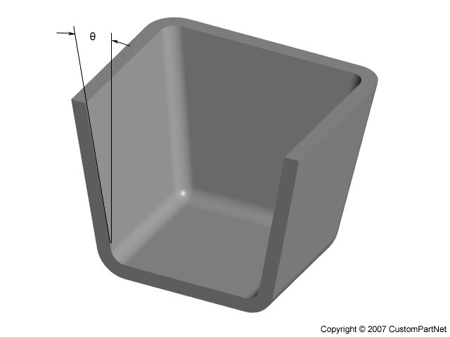

Draft
  • Apply a draft angle of 1° - 2° to all walls parallel to the parting direction to facilitate removing the part from the mold
No draft angle
INCORRECT
No draft angle
Draft angle
CORRECT
Draft angle (θ)

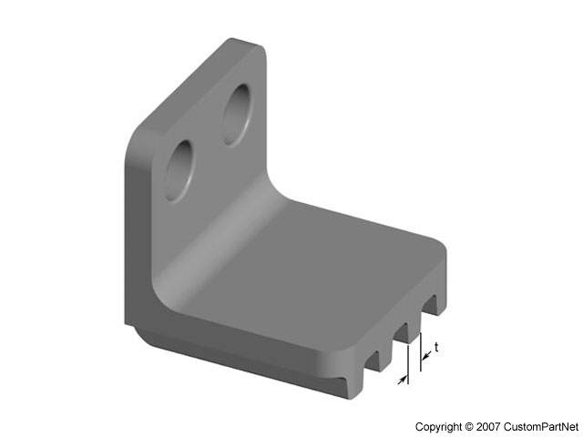

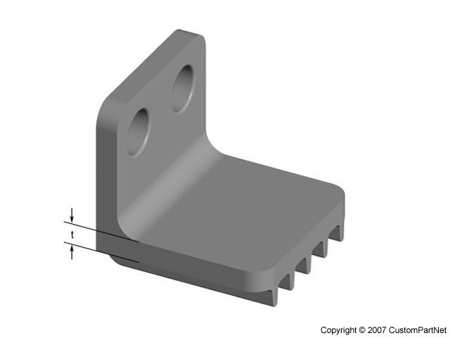

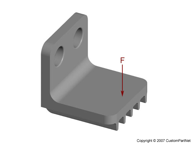

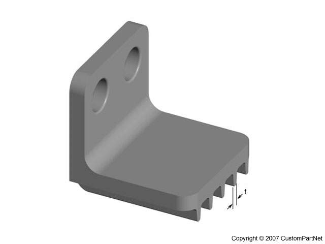

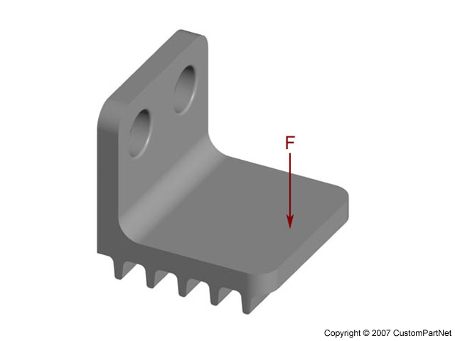

Ribs
  • Add ribs for structural support, rather than increasing the wall thickness
  • Orient ribs perpendicular to the axis about which bending may occur
  • Thickness of ribs should be 50-60% of the walls to which they are attached
  • Height of ribs should be less than three times the wall thickness
  • Round the corners at the point of attachment
  • Apply a draft angle of at least 0.25°
Thick wall of thickness t
INCORRECT
Thin wall of thickness t with ribs
CORRECT
Incorrect rib direction under load
INCORRECT
Incorrect rib direction under load F
Correct rib direction under load
CORRECT
Correct rib direction under load F
Thick rib of thickness t
INCORRECT
Thin rib of thickness t
CORRECT
Close up of ribs
Close up of ribs

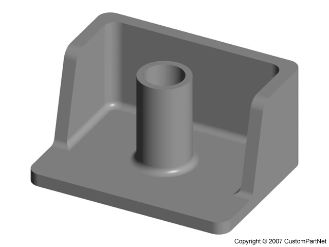

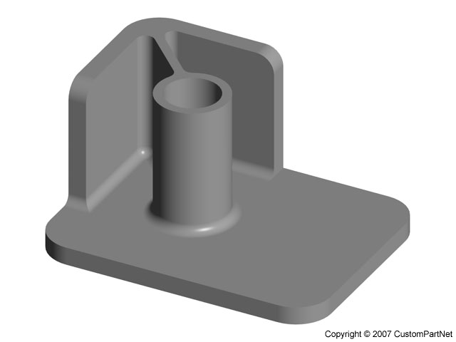

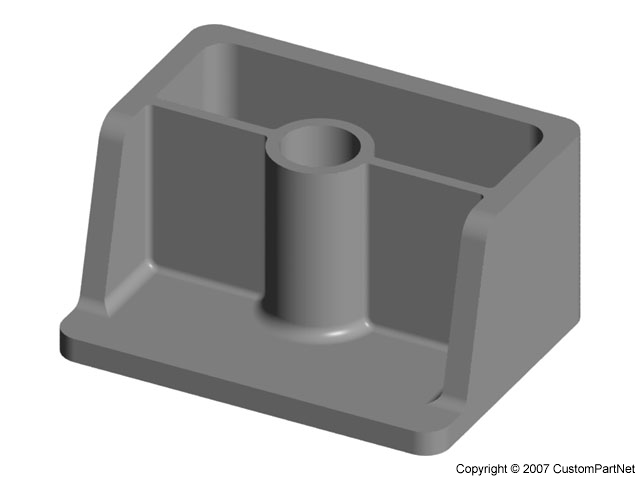

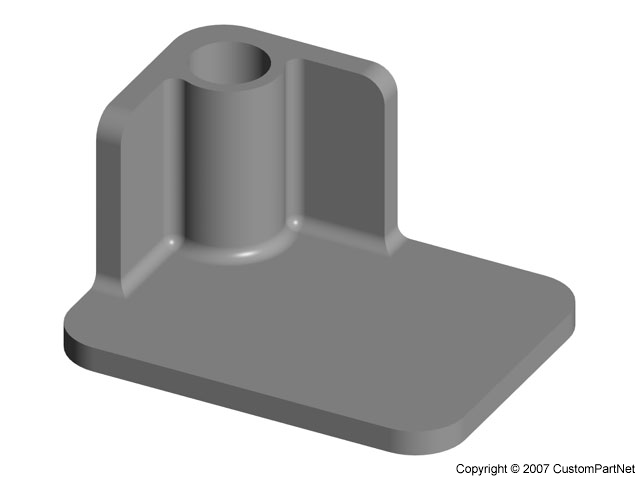

Bosses
  • Wall thickness of bosses should be no more than 60% of the main wall thickness
  • Radius at the base should be at least 25% of the main wall thickness
  • Should be supported by ribs that connect to adjacent walls or by gussets at the base
  • If a boss must be placed near a corner, it should be isolated using ribs
Isolated boss
INCORRECT
Isolated boss
Isolated boss with ribs
CORRECT
Boss with ribs
Isolated boss with gussets
CORRECT
Boss with gussets
Boss in corner
INCORRECT
Boss in corner
Ribbed boss in corner
CORRECT

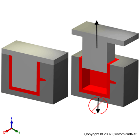

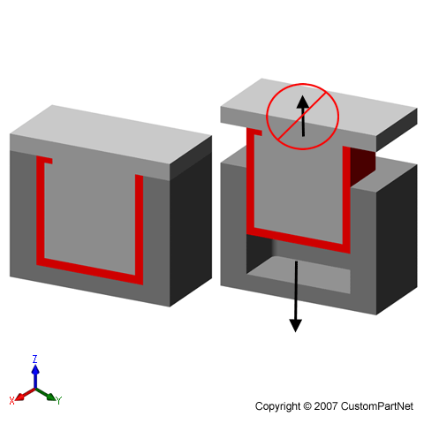

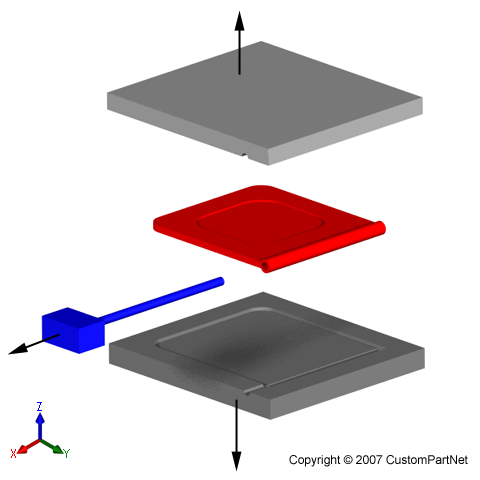

Undercuts
  • Minimize the number of external undercuts
  • External undercuts require side-cores which add to the tooling cost
  • Some simple external undercuts can be molded by relocating the parting line
  • Redesigning a feature can remove an external undercut
  • Minimize the number of internal undercuts
  • Internal undercuts often require internal core lifters which add to the tooling cost

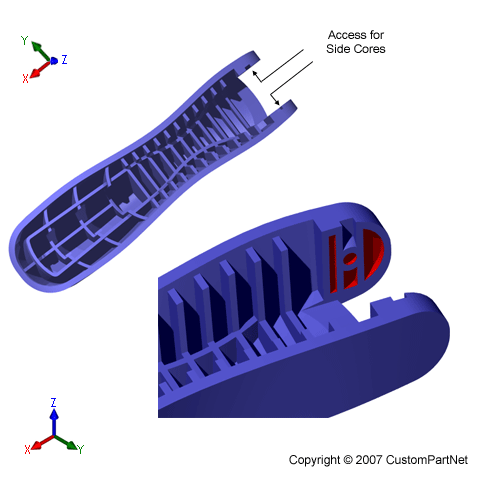

  • Designing an opening in the side of a part can allow a side-core to form an internal undercut
  • Minimize number of side-action directions
  • Additional side-action directions will limit the number of possible cavities in the mold
Simple external undercut
Mold cannot separate
New parting line allows undercut

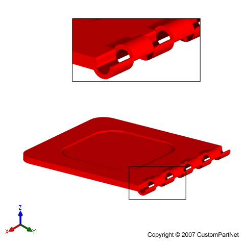

Part with hinge
Part with hinge
Hinge requires side-core
Redesigned hinge
Redesigned hinge
New hinge can be molded

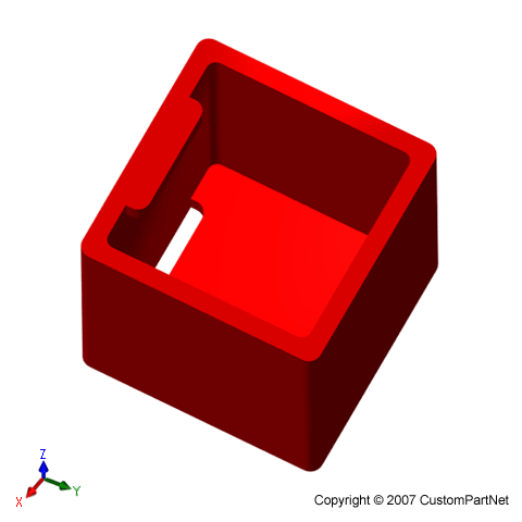

Internal undercut accessible from the side
Part with internal undercut
Mold cannot separate (internal)
Part redesigned with slot
New part can be molded
