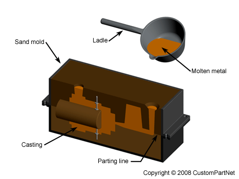

  3. Pouring - The molten metal is maintained at a set temperature in a furnace. After the mold has been clamped, the molten metal can be ladled from its holding container in the furnace and poured into the mold. The pouring can be performed manually or by an automated machine. Enough molten metal must be poured to fill the entire cavity and all channels in the mold. The filling time is very short in order to prevent early solidification of any one part of the metal.
  4. Cooling - The molten metal that is poured into the mold will begin to cool and solidify once it enters the cavity. When the entire cavity is filled and the molten metal solidifies, the final shape of the casting is formed. The mold can not be opened until the cooling time has elapsed. The desired cooling time can be estimated based upon the wall thickness of the casting and the temperature of the metal. Most of the possible defects that can occur are a result of the solidification process. If some of the molten metal cools too quickly, the part may exhibit shrinkage, cracks, or incomplete sections.
  5. Removal - After the predetermined solidification time has passed, the sand mold can simply be broken, and the casting removed. This step, sometimes called shakeout, is typically performed by a vibrating machine that shakes the sand and casting out of the flask. Once removed, the casting will likely have some sand and oxide layers adhered to the surface. Shot blasting is sometimes used to remove any remaining sand, especially from internal surfaces, and reduce the surface roughness.
  6. Trimming - During cooling, the material from the channels in the mold solidifies attached to the part. This excess material must be trimmed from the casting either manually via cutting or sawing, or using a trimming press. The time required to trim the excess material can be estimated from the size of the casting's envelope. A larger casting will require a longer trimming time. The scrap material that results from this trimming is either discarded or reused in the sand casting process.

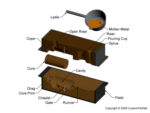

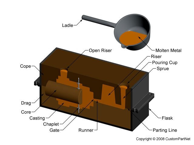

Mold
In sand casting, the primary piece of equipment is the mold, which contains several components. The mold is divided into two halves - the cope (upper half) and the drag (bottom half), which meet along a parting line. Both mold halves are contained inside a box, called a flask, which itself is divided along this parting line. The mold cavity is formed by packing sand around the pattern in each half of the flask. The sand can be packed by hand, but machines that use pressure or impact ensure even packing of the sand and require far less time, thus increasing the production rate. After the sand has been packed and the pattern is removed, a cavity will remain that forms the external shape of the casting. Some internal surfaces of the casting may be formed by cores.
Cores are additional pieces that form the internal holes and passages of the casting. Cores are typically made out of sand so that they can be shaken out of the casting, rather than require the necessary geometry to slide out. As a result, sand cores allow for the fabrication of many complex internal features. Each core is positioned in the mold before the molten metal is poured. In order to keep each core in place, the pattern has recesses called core prints where the core can be anchored in place.

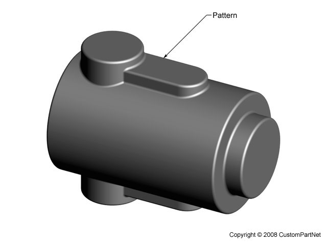

The main tooling for sand casting is the pattern that is used to create the mold cavity. The pattern is a full size model of the part that makes an impression in the sand mold. However, some internal surfaces may not be included in the pattern, as they will be created by separate cores. The pattern is actually made to be slightly larger than the part because the casting will shrink inside the mold cavity. Also, several identical patterns may be used to create multiple impressions in the sand mold, thus creating multiple cavities that will produce as many parts in one casting.
Several different materials can be used to fabricate a pattern, including wood, plastic, and metal. Wood is very common because it is easy to shape and is inexpensive, however it can warp and deform easily. Wood also will wear quicker from the sand. Metal, on the other hand, is more expensive, but will last longer and has higher tolerances. The pattern can be reused to create the cavity for many molds of the same part. Therefore, a pattern that lasts longer will reduce tooling costs. A pattern for a part can be made many different ways, which are classified into the following four types:
  • Solid pattern - A solid pattern is a model of the part as a single piece. It is the easiest to fabricate, but can cause some difficulties in making the mold. The parting line and runner system must be determined separately. Solid patterns are typically used for geometrically simple parts that are produced in low quantities.
Sand Casting Solid Pattern
Solid pattern

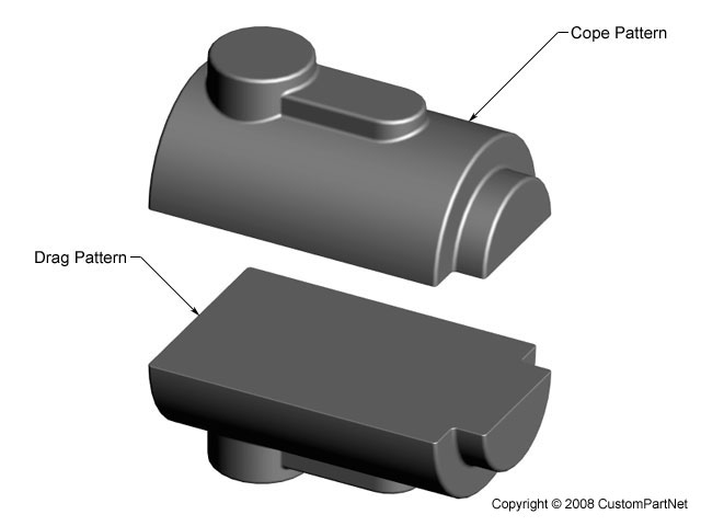

  • Split pattern - A split pattern models the part as two separate pieces that meet along the parting line of the mold. Using two separate pieces allows the mold cavities in the cope and drag to be made separately and the parting line is already determined. Split patterns are typically used for parts that are geometrically complex and are produced in moderate quantities.
Sand Casting Split Pattern
Split pattern

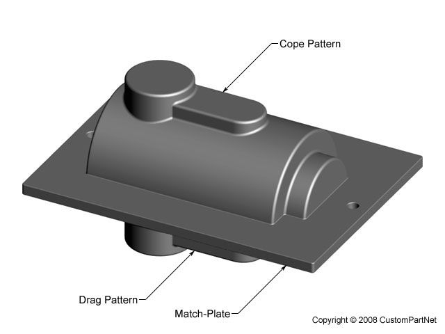

  • Match-plate pattern - A match-plate pattern is similar to a split pattern, except that each half of the pattern is attached to opposite sides of a single plate. The plate is usually made from wood or metal. This pattern design ensures proper alignment of the mold cavities in the cope and drag and the runner system can be included on the match plate. Match-plate patterns are used for larger production quantities and are often used when the process is automated.
Tooling Match-plate pattern
Match-plate pattern

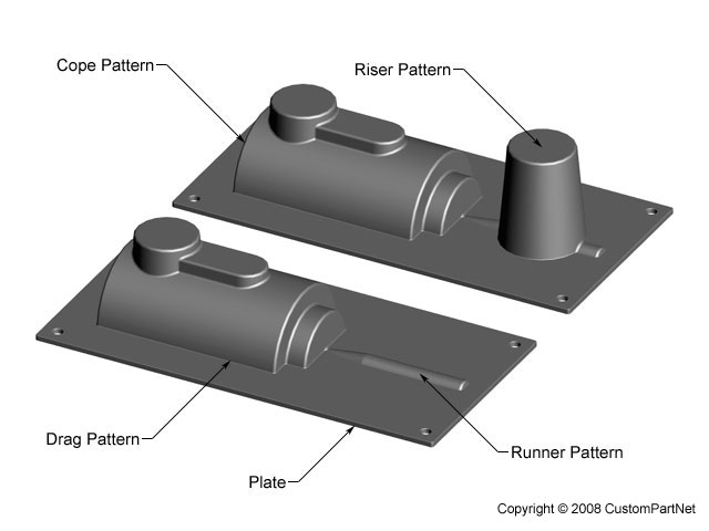

  • Cope and drag pattern - A cope and drag pattern is similar to a match plate pattern, except that each half of the pattern is attached to a separate plate and the mold halves are made independently. Just as with a match plate pattern, the plates ensure proper alignment of the mold cavities in the cope and drag and the runner system can be included on the plates. Cope and drag patterns are often desirable for larger castings, where a match-plate pattern would be too heavy and cumbersome. They are also used for larger production quantities and are often used when the process is automated.
Tooling Cope and drag pattern

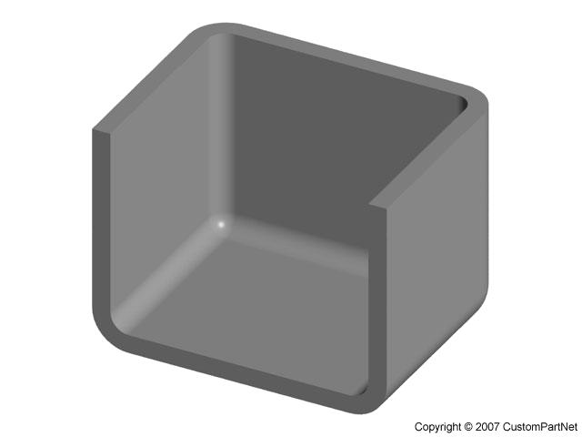

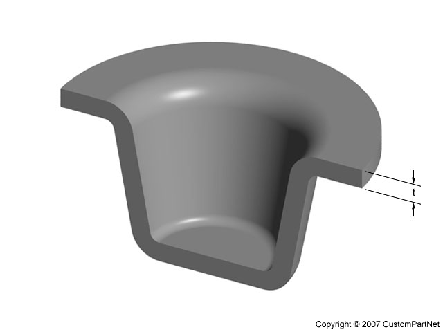

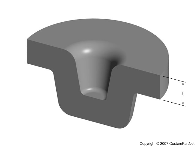

Maximum wall thickness
  • Decrease the maximum wall thickness of a part to shorten the cycle time (cooling time specifically) and reduce the part volume
INCORRECT
Part with thick walls
CORRECT
Part redesigned with thin walls

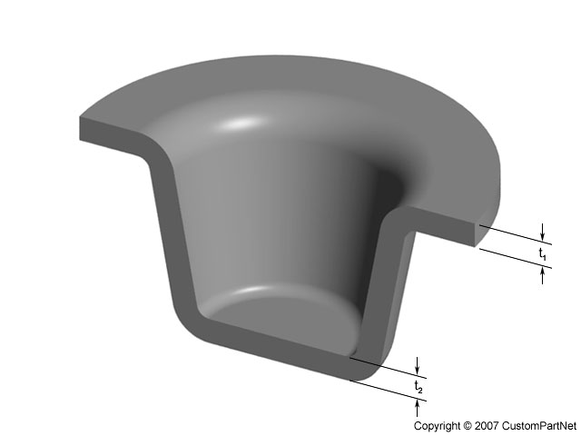

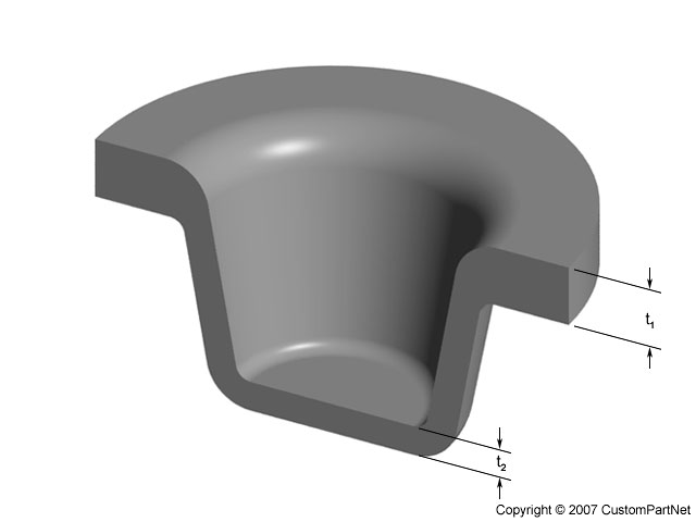

  • Uniform wall thickness will ensure uniform cooling and reduce defects. A thick section, often referred to as a hot spot, causes uneven cooling and can result in shrinkage, porosity, or cracking.
INCORRECT
Non-uniform wall thickness
Non-uniform wall thickness (t₁ ≠ t₂)
CORRECT
Uniform wall thickness (t₁ = t₂)

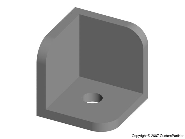

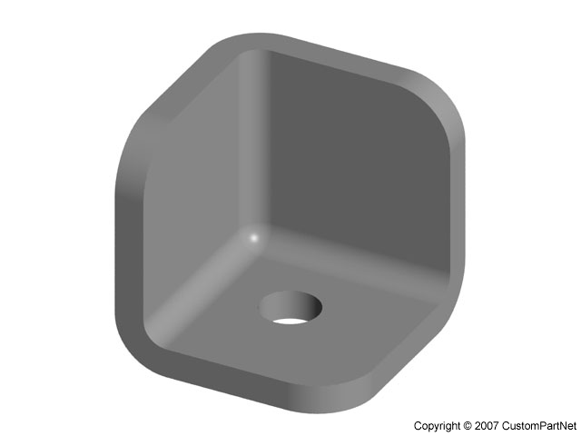

Corners
  • Round corners to reduce stress concentrations and fracture
  • Inner radius should be at least the thickness of the walls
INCORRECT
Sharp corner
Sharp corner
CORRECT
Rounded corner
Rounded corner

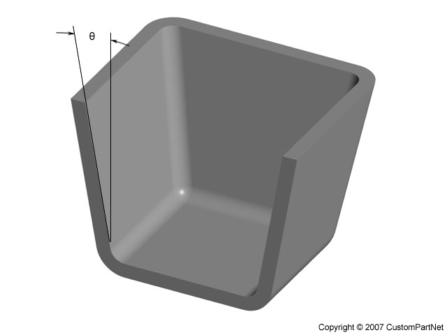

Draft
  • Apply a draft angle of 2° - 3° to all walls parallel to the parting direction to facilitate removing the part from the mold.
INCORRECT
No Draft Angle
No draft angle
CORRECT
Draft Angle
Draft angle (θ)
