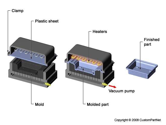

  • Vacuum forming - A vacuum is formed between the mold cavity and the thermoplastic sheet. The vacuum pressure (typically 14 psi) forces the sheet to conform to the mold and form the part shape.
    Vacuum Forming
    Vacuum Forming

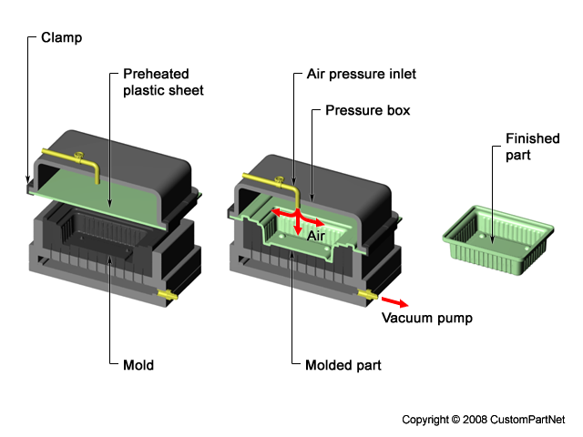

  • Pressure forming - In addition to utilizing a vacuum underneath the sheet, air pressure (typically 50 psi, but up to 100 psi) is applied on the back side of the sheet to help force it onto the mold. This additional force allows the forming of thicker sheets and creating finer details, textures, undercuts, and sharp corners.
    Pressure Forming
    Pressure Forming

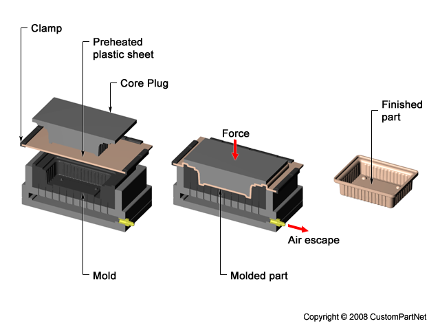

  • Mechanical forming - The thermoplastic sheet is mechanically forced into or around the mold by direct contact. Typically, a core plug will push the sheet into the mold cavity and force it into the desired shape.
    Mechanical Forming
    Mechanical Forming
