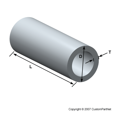

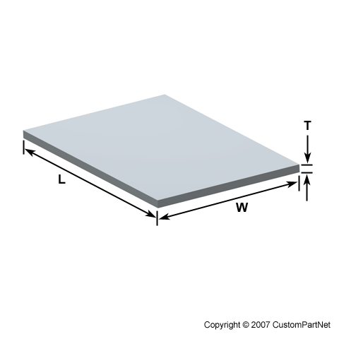

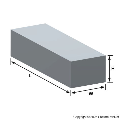

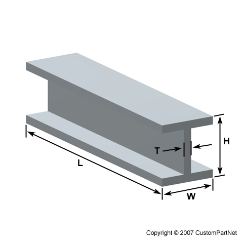

Machining is a term used to describe a variety of material removal processes in which a cutting tool removes unwanted material from a workpiece to produce the desired shape. The workpiece is typically cut from a larger piece of stock, which is available in a variety of standard shapes, such as flat sheets, solid bars, hollow tubes, and shaped beams. Machining can also be performed on an existing part, such as a casting or forging.

I-beam
I-beam

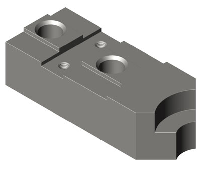

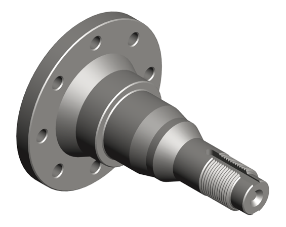

Parts that are machined from a pre-shaped workpiece are typically cubic or cylindrical in their overall shape, but their individual features may be quite complex. Machining can be used to create a variety of features including holes, slots, pockets, flat surfaces, and even complex surface contours. Also, while machined parts are typically metal, almost all materials can be machined, including metals, plastics, composites, and wood. For these reasons, machining is often considered the most common and versatile of all manufacturing processes.

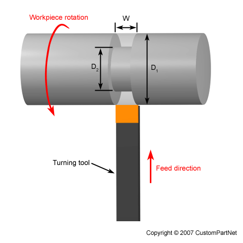

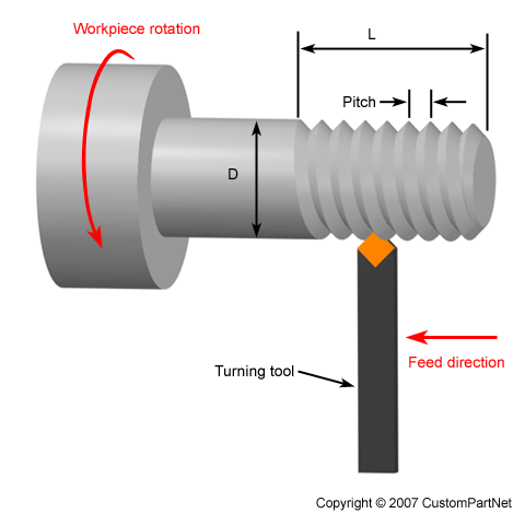

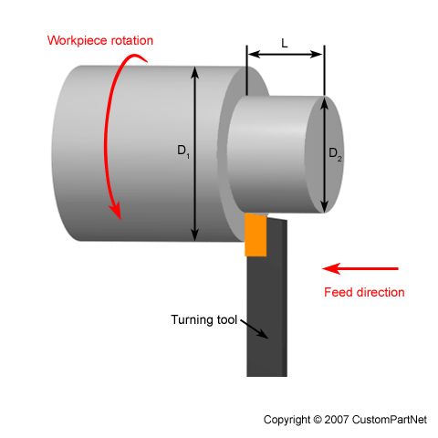

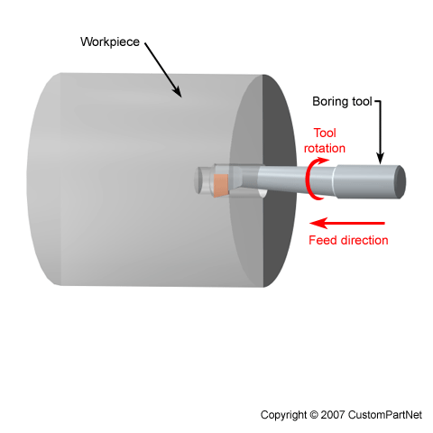

Single point cutting refers to using a cutting tool with a single sharp edge that is used to remove material from the workpiece. The most common single point cutting process is turning, in which the workpiece rotates and the cutting tool feeds into the workpiece, cutting away material. Turning is performed on a lathe or turning machine and produces cylindrical parts that may have external or internal features. Turning operations such as turning, boring, facing, grooving, cut-off (parting), and thread cutting allow for a wide variety of features to be machined, including slots, tapers, threads, flat surfaces, and complex contours. Other single point cutting processes exist that do not require the workpiece to rotate, such as planing and shaping.
Turning operation
Turning
Boring operation
Boring

Thread cutting operation
Thread cutting

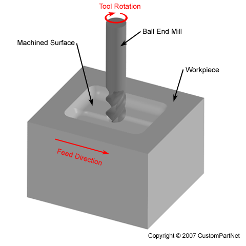

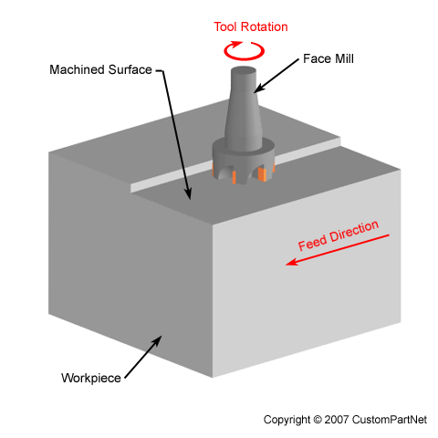

Multi-point cutting refers to using a cutting tool with many sharp teeth that moves against the workpiece to remove material. The two most common multi-point cutting processes are milling and drilling. In both processes, the cutting tool is cylindrical with sharp teeth around its perimeter and rotates at high speeds. In milling, the workpiece is fed into the rotating tool along different paths and depths to create a variety of features. Performed on a milling machine, milling operations such as end milling, chamfer milling, and face milling are used to create slots, chamfers, pockets, flat surfaces, and complex contours. Milling machines can also perform drilling and other hole-making operations as well.
End milling operation
End milling
Face milling operation
Face milling

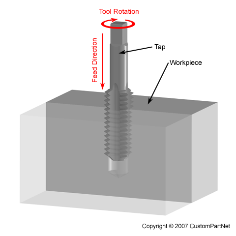

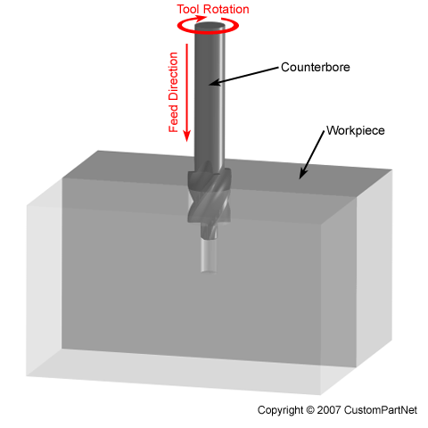

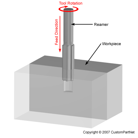

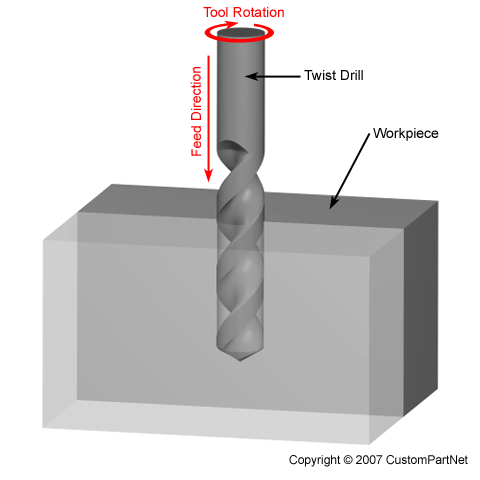

In drilling, the rotating tool is fed vertically into the stationary workpiece to create a hole. A drill press is specifically designed for drilling, but milling machines and turning machines can also perform this process. Drilling operations such as counterboring, countersinking, reaming, and tapping can be used to create recessed holes, high precision holes, and threaded holes. Other multi-point cutting processes exist that do not require the tool to rotate, such as broaching and sawing.
Drilling operation
Drilling
Counterboring operation
Counterboring
Reaming operation
Reaming
Tapping operation
Tapping
