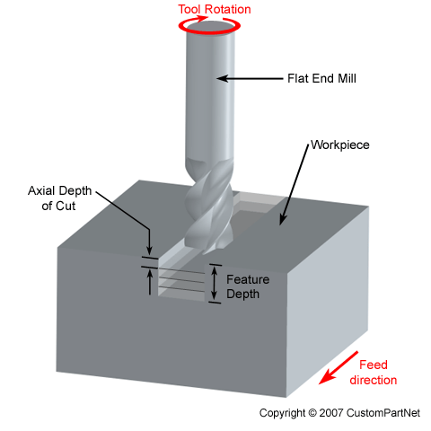

  • Axial depth of cut - The depth of the tool along its axis in the workpiece as it makes a cut. A large axial depth of cut will require a low feed rate, or else it will result in a high load on the tool and reduce the tool life. Therefore, a feature is typically machined in several passes as the tool moves to the specified axial depth of cut for each pass.
Axial depth of cut

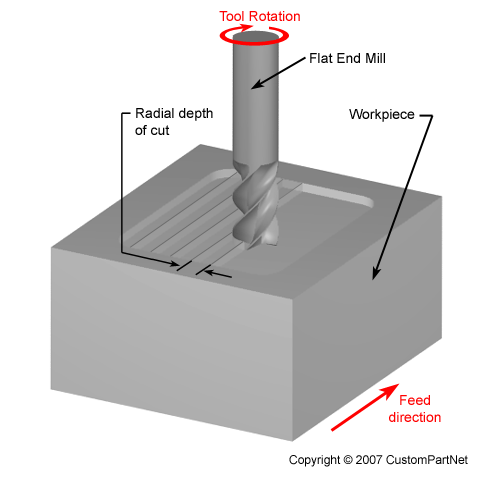

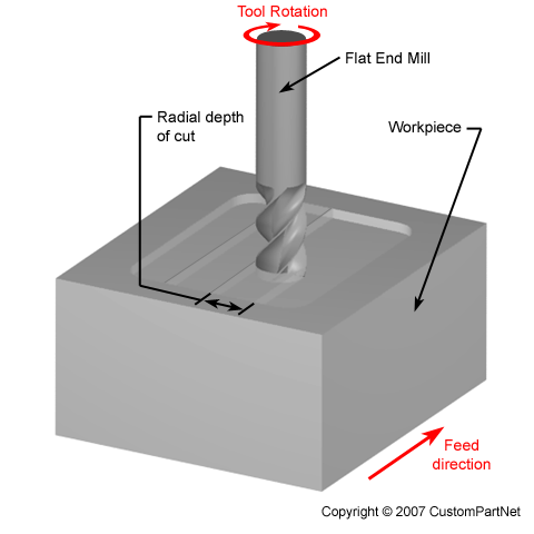

  • Radial depth of cut - The depth of the tool along its radius in the workpiece as it makes a cut. If the radial depth of cut is less than the tool radius, the tool is only partially engaged and is making a peripheral cut. If the radial depth of cut is equal to the tool diameter, the cutting tool is fully engaged and is making a slot cut. A large radial depth of cut will require a low feed rate, or else it will result in a high load on the tool and reduce the tool life. Therefore, a feature is often machined in several steps as the tool moves over the step-over distance, and makes another cut at the radial depth of cut.
Radial depth of cut (Peripheral cut)
Peripheral cut
Radial depth of cut (Slot cut)
Slot cut

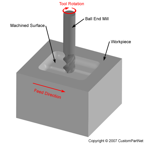

  • End milling - An end mill makes either peripheral or slot cuts, determined by the step-over distance, across the workpiece in order to machine a specified feature, such as a profile, slot, pocket, or even a complex surface contour. The depth of the feature may be machined in a single pass or may be reached by machining at a smaller axial depth of cut and making multiple passes.
End milling operation (Pocket milling)

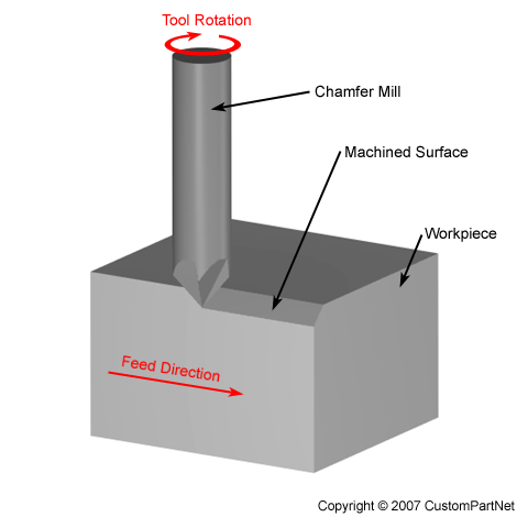

  • Chamfer milling - A chamfer end mill makes a peripheral cut along an edge of the workpiece or a feature to create an angled surface, known as a chamfer. This chamfer, typically with a 45 degree angle, can be machined on either the exterior or interior of a part and can follow either a straight or curved path.
Chamfer milling operation

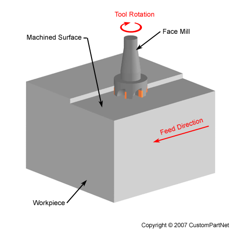

  • Face milling - A face mill machines a flat surface of the workpiece in order to provide a smooth finish. The depth of the face, typically very small, may be machined in a single pass or may be reached by machining at a smaller axial depth of cut and making multiple passes.
Face milling operation

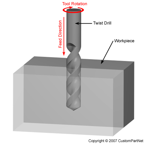

  • Drilling - A drill enters the workpiece axially and cuts a hole with a diameter equal to that of the tool. A drilling operation can produce a blind hole, which extends to some depth inside the workpiece, or a through hole, which extends completely through the workpiece.
Drilling operation

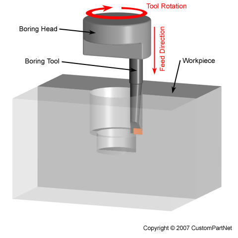

  • Boring - A boring tool enters the workpieceaxially and cuts along an internal surface to form different features. The boring tool is a single-point cutting tool, which can be set to cut the desired diameter by using an adjustable boring head. Boring is commonly performed after drilling a hole in order to enlarge the diameter or obtain more precise dimensions.
Boring operation

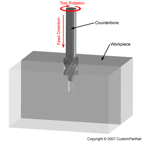

  • Counterboring - An counterbore tool enters the workpiece axially and enlarges the top portion of an existing hole to the diameter of the tool. Counterboring is often performed after drilling to provide space for the head of a fastener, such as a bolt, to sit below the surface of a part. The counterboring tool has a pilot on the end to guide it straight into the existing hole.
Counterboring operation

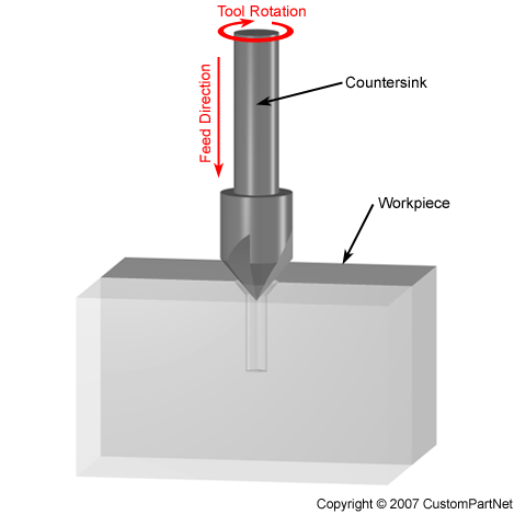

  • Countersinking - A countersink tool enters the workpieceaxially and enlarges the top portion of an existing hole to a cone-shaped opening. Countersinking is often performed after drilling to provide space for the head of a fastener, such as a screw, to sit flush with the workpiece surface. Common included angles for a countersink include 60, 82, 90, 100, 118, and 120 degrees.
Countersinking operation

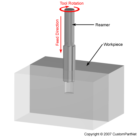

  • Reaming - A reamer enters the workpiece axially and enlarges an existing hole to the diameter of the tool. Reaming removes a minimal amount of material and is often performed after drilling to obtain both a more accurate diameter and a smoother internal finish.

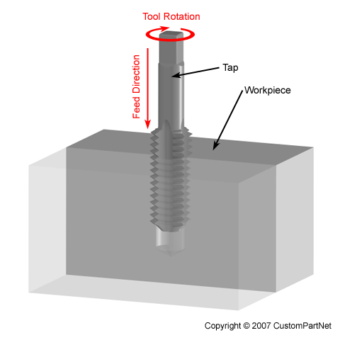

  • Tapping - A tap enters the workpieceaxially and cuts internal threads into an existing hole. The existing hole is typically drilled by the required tap drill size that will accommodate the desired tap. Threads may be cut to a specified depth inside the hole (bottom tap) or the complete depth of a through hole (through tap).
Tapping operation

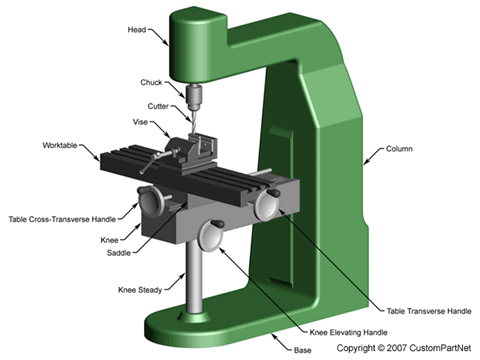

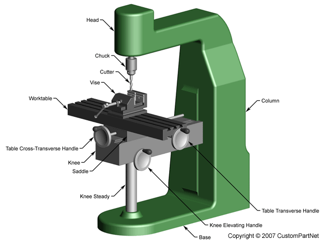

Milling machines can be found in a variety of sizes and designs, yet they still possess the same main components that enable the workpiece to be moved in three directions relative to the tool. These components include the following:
  • Base and column - The base of a milling machine is simply the platform that sits on the ground and supports the machine. A large column is attached to the base and connects to the other components.
  • Table - The workpiece that will be milled is mounted onto a platform called the table, which typically has "T" shaped slots along its surface. The workpiece may be secured in a fixture called a vise, which is secured into the T-slots, or the workpiece can be clamped directly into these slots. The table provides the horizontal motion of the workpiece in the X-direction by sliding along a platform beneath it, called the saddle.
  • Saddle - The saddle is the platform that supports the table and allows its longitudinal motion. The saddle is also able to move and provides the horizontal motion of the workpiece in the Y-direction by sliding transversely along another platform called the knee.
  • Knee - The knee is the platform that supports the saddle and the table. In most milling machines, sometimes called column and knee milling machines, the knee provides the vertical motion (Z direction) of the workpiece. The knee can move vertically along the column, thus moving the workpiece vertically while the cutter remains stationary above it. However, in a fixed bed machine, the knee is fixed while the cutter moves vertically in order to cut the workpiece.
Manual vertical milling machine

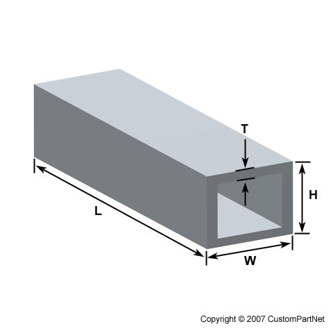

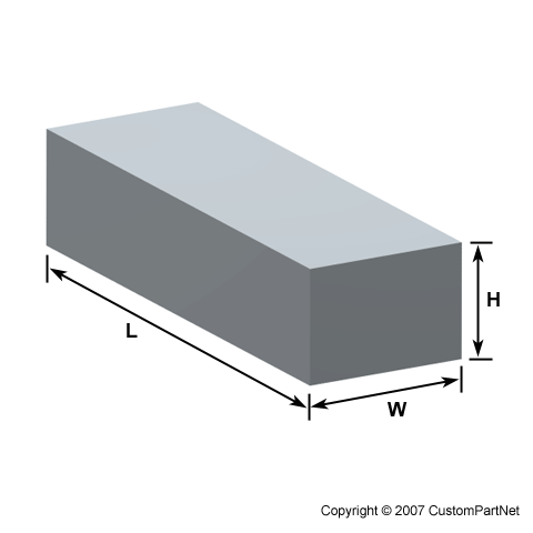

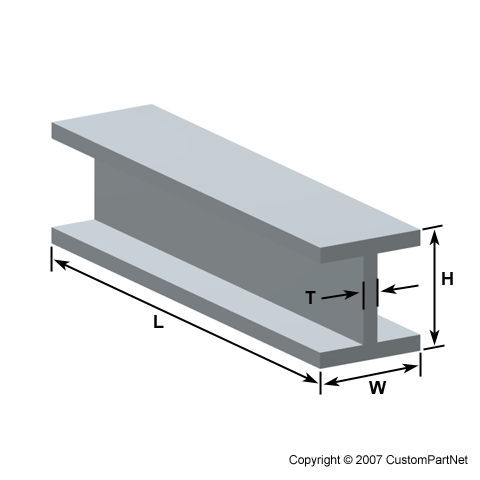

In milling, the raw form of the material is a piece of stock from which the workpieces are cut. This stock is available in a variety of shapes such as flat sheets, solid bars (rectangular, cylindrical, hexagonal, etc.), hollow tubes (rectangular, cylindrical, etc.), and shaped beams (I-beams, L-beams, T-beams, etc.). Custom extrusions or existing parts such as castings or forgings are also sometimes used.
Rectangular bar
Rectangular bar
Rectangular tube
Rectangular tube
I-beam
I-beam
