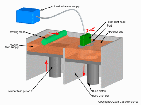

The 3D printing process begins with
the powder supply being raised by a piston and a
leveling roller distributing a thin layer of powder to
the top of the build chamber. A multi-channel ink-jet
print head then deposits a liquid adhesive to targeted
regions of the powder bed. These regions of powder are
bonded together by the adhesive and form one layer of
the part. The remaining free standing powder supports
the part during the build. After a layer is built, the
build platform is lowered and a new layer of powder
added, leveled, and the printing repeated. After the
part is completed, the loose supporting powder can be
brushed away and the part removed. 3D printed parts are
typically infiltrated with a sealant to improve strength
and surface finish.
