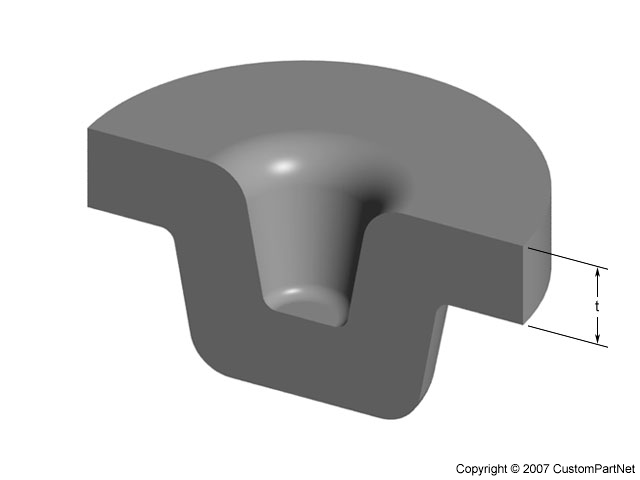

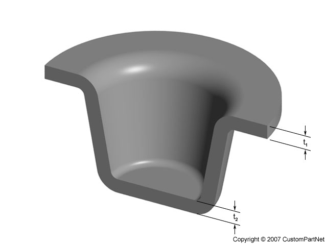

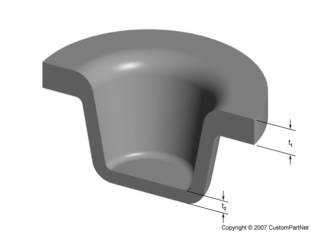

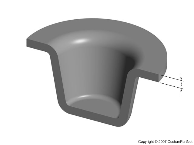

Maximum wall thickness
- Decrease the maximum wall thickness of a part to shorten the cycle time (injection time and cooling time specifically) and reduce the part volume
- Uniform wall thickness will ensure uniform cooling and reduce defects

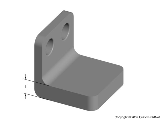

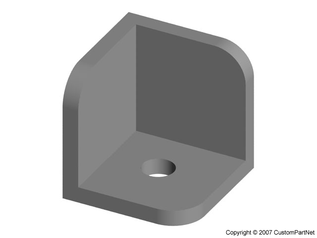

Corners
- Round corners to reduce stress concentrations and fracture
- Inner radius should be at least the thickness of the walls

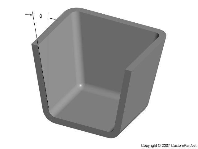

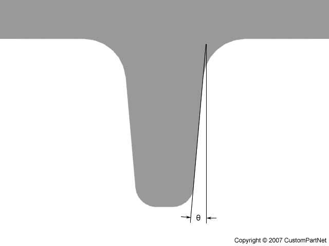

Draft
- Apply a draft angle of 1° - 2° to all walls parallel to the parting direction to facilitate removing the part from the mold.

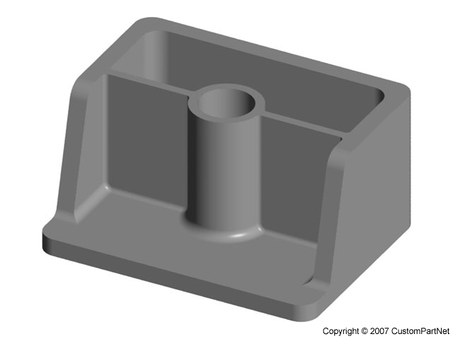

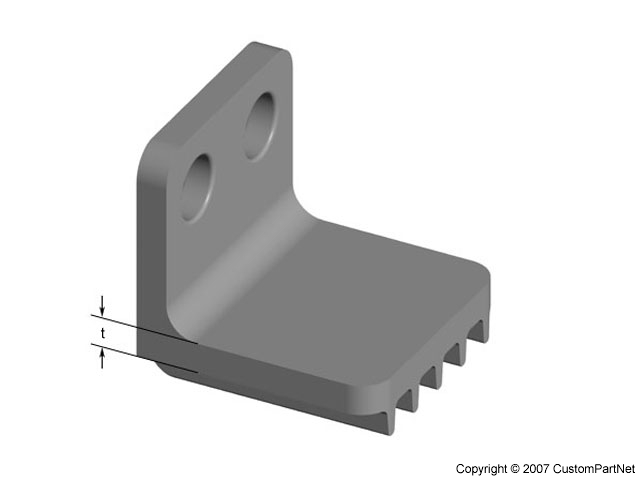

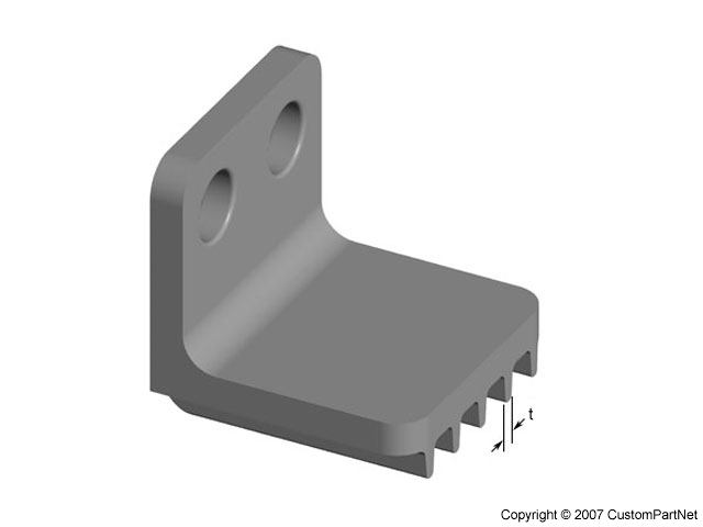

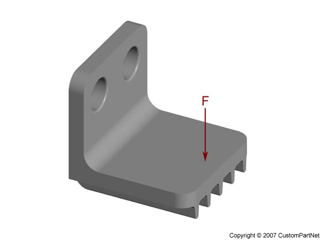

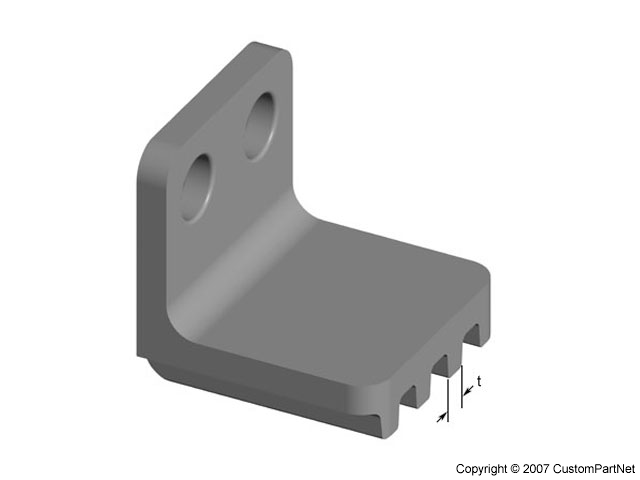

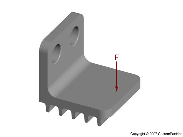

Ribs
- Add ribs for structural support, rather than increasing the wall thickness
- Orient ribs perpendicular to the axis about which bending may occur
- Thickness of ribs should be 50-60% of the walls to which they are attached
- Height of ribs should be less than three times the wall thickness
- Round the corners at the point of attachment
- Apply a draft angle of at least 0.25°

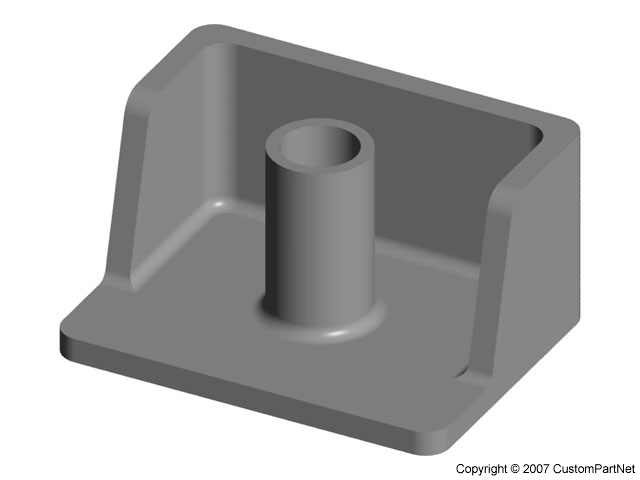

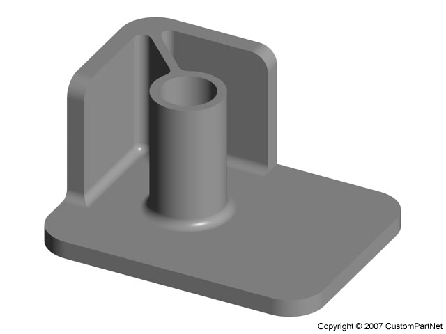

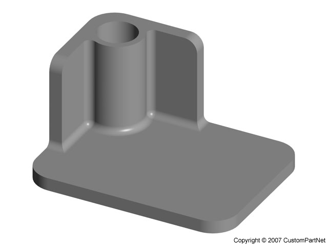

Bosses
- Wall thickness of bosses should be no more than 60% of the main wall thickness
- Radius at the base should be at least 25% of the main wall thickness
- Should be supported by ribs that connect to adjacent walls or by gussets at the base.
- If a boss must be placed near a corner, it should be isolated using ribs.

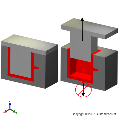

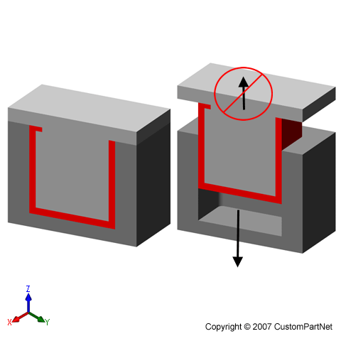

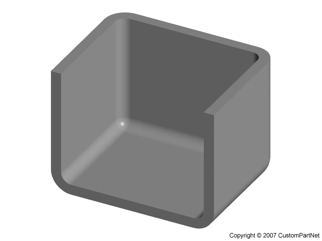

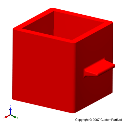

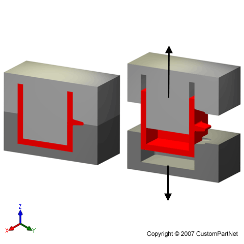

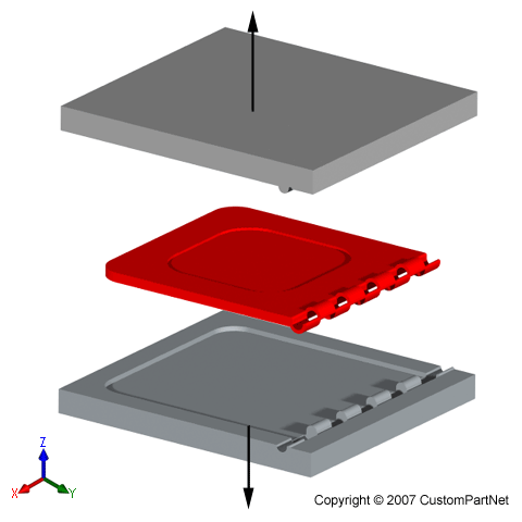

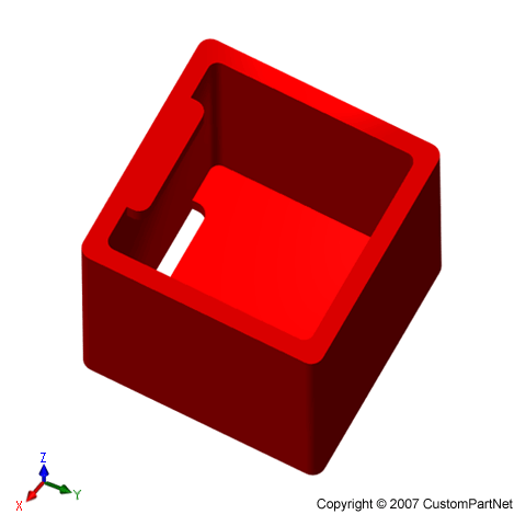

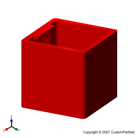

Undercuts
- Minimize the number of external undercuts
- External undercuts require side-cores which add to the tooling cost
- Some simple external undercuts can be molded by relocating the parting line
- Redesigning a feature can remove an external undercut

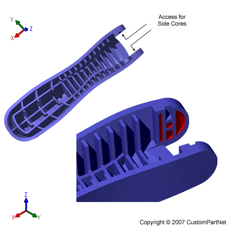

- Minimize the number of internal undercuts
- Internal undercuts often require internal core lifters which add to the tooling cost
- Designing an opening in the side of a part can allow a side-core to form an internal undercut
- Redesigning a part can remove an internal undercut
- Minimize number of side-action directions
- Additional side-action directions will limit the number of possible cavities in the mold
