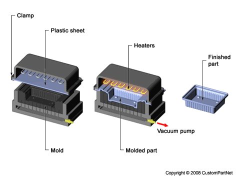

Vacuum forming - A vacuum is formed between the mold cavity and the thermoplastic sheet.
The vacuum pressure (typically 14 psi) forces the sheet to conform to the mold and form the part
shape.

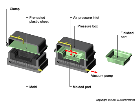

Pressure forming - In addition to utilizing a vacuum underneath the sheet, air pressure
(typically 50 psi, but up to 100 psi) is applied on the back side of the sheet to help force it
onto the mold. This additional force allows the forming of thicker sheets and creating finer
details, textures, undercuts, and sharp corners.

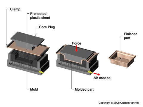

Mechanical forming - The thermoplastic sheet is mechanically forced into or around the mold
by direct contact. Typically, a core plug will push the sheet into the mold cavity and force it
into the desired shape.
