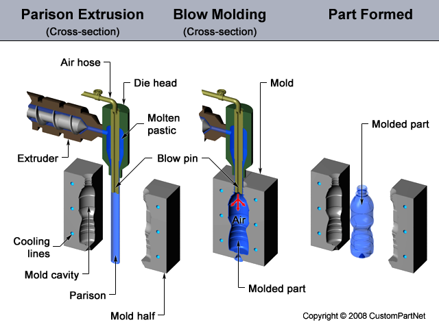

Blow molding is a manufacturing process that is used to create hollow plastic parts by inflating a heated plastic tube until it fills a mold and forms the desired shape. The raw material in this process is a thermoplastic in the form of small pellets or granules, which is first melted and formed into a hollow tube, called the parison. There are various ways of forming the parison, as explained below. The parison is then clamped between two mold halves and inflated by pressurized air until it conforms to the inner shape of the mold cavity. Typical pressures are 25 to 150 psi, far less than for injection molding. Lastly, after the part has cooled, the mold halves are separated and the part is ejected.

  • Extrusion blow molding - An extruder uses a rotating screw to force the molten plastic through a die head that forms the parison around a blow pin. The parison is extruded vertically between the two open mold halves, so they can close on the parison and blow pin. Pressurized air flows through the blow pin to inflate the parison. This is the most common type of blow molding and is used to manufacture large quantities of relatively simple parts.
