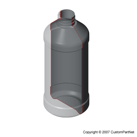

A pocket in a part which has inward curving surfaces, but are not completely enclosed. A solid object that fills such a cavity could not be removed. Many manufacturing processes are incapable of producing parts with such a feature.
![]() Bottle with captured cavity (Cross-section shown in red) |

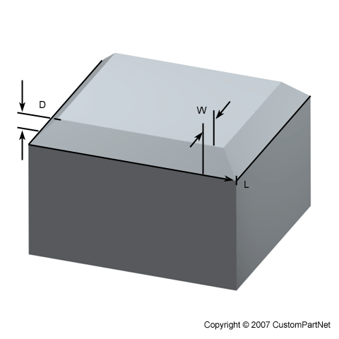

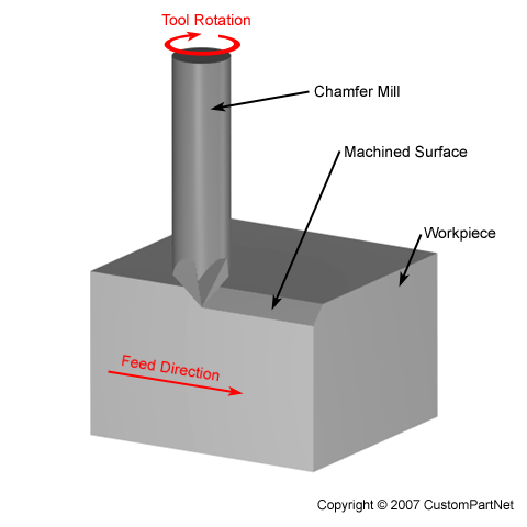

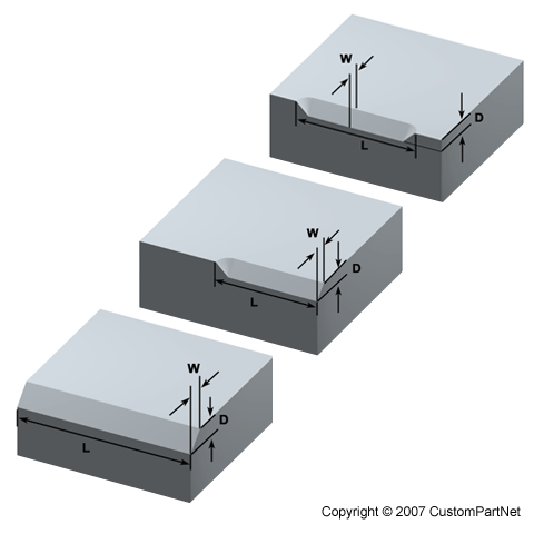

An operation in which a chamfer mill makes a peripheral cut along an edge of the workpiece or a feature to create an angled surface, known as a chamfer. It is assumed that the angle of the chamfer is 45 degrees, so that the chamfer width is equal to its height. The chamfer length can be the complete perimeter of a workpiece or feature, just one side, or even a part of a side. Also, a chamfer can be machined on either the exterior or interior of a part and can follow either a straight or curved path.
![]() Chamfer milling operation |
![]() Complete chamfer |
![]() Side chamfers (0 ends, 1 end, 2 ends) |

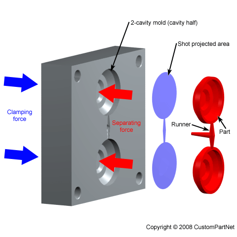

The force that is applied to a mold by the molding machine in order to keep it securely closed while the material is injected. The clamp force is typically some factor of safety greater than the separating force, which is the outward force exerted on the mold halves by the injected material.
Clamping force |

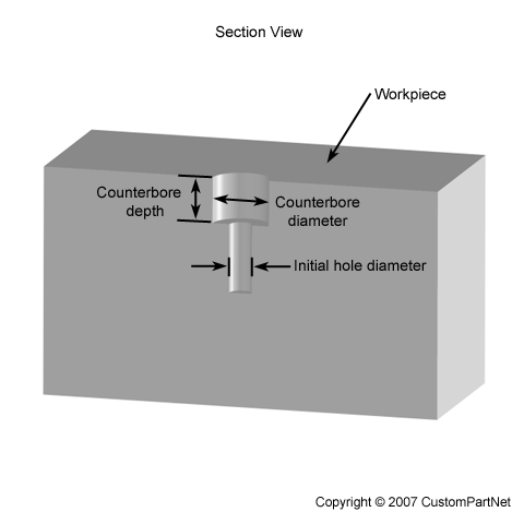

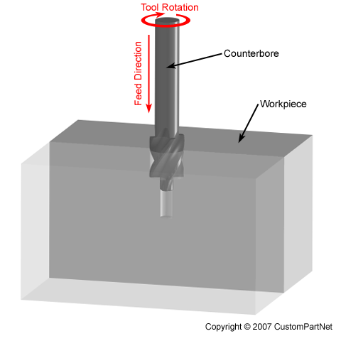

An operation in which a counterbore tool enters the workpiece axially and enlarges the top portion of an existing hole to the diameter of the tool. Counterboring is often performed after drilling to provide space for the head of a fastener, such as a bolt, to sit below the surface of a part. The counterboring tool has a pilot on the end to guide it straight into the existing hole.
![]() Counterboring operation |
![]() Counterbored hole |

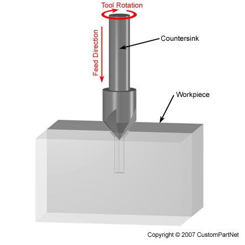

An operation in which a countersink tool enters the workpiece axially and enlarges the top portion of an existing hole to a cone-shaped opening. Countersinking is often performed after drilling to provide space for the head of a fastener, such as a screw, to sit flush with the workpiece surface. Common included angles for a countersink include 60, 82, 90, 100, 118, and 120 degrees.
![]() Countersinking operation |

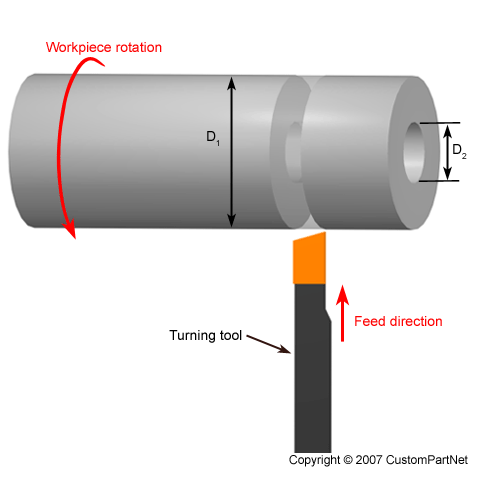

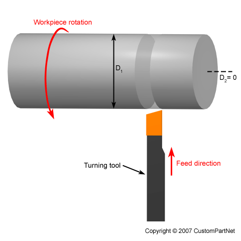

A turning operation, also known as parting, in which a single-point cut-off tool moves radially, into the side of the workpiece, and continues until the center or inner diameter of the workpiece is reached, thus parting or cutting off a section of the workpiece. A part catcher is often used to catch the removed part.
![]() Cut-off to center |
![]() Cut-off to inner diameter |

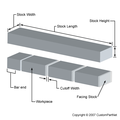

The width of the cut when cutting a workpiece from a piece of bar stock. The cutoff width is used in determining how many workpieces a single piece of bar stock will yield.
![]() Bar stock |
