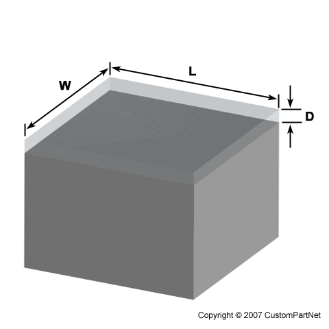

Face milling
An operation in which a face mill machines a flat surface of the workpiece in order to provide a smooth finish. The depth of the face, typically very small, may be machined in a single pass or may be reached by machining at a smaller axial depth of cut and making multiple passes. For a rough operation, the recommended cutting speed and feed for face milling are used. A finish operation will lower the cutting feed according to the finish requirements.

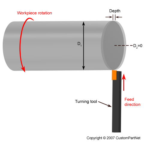

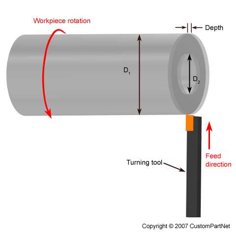

Facing
A turning operation in which a single-point tool moves radially, along the end of the workpiece, removing a thin layer of material to provide a smooth flat surface. The cutting tool moves from the outer diameter to the center or inner diameter of the workpiece or can move in the opposite direction. The depth of the face, typically very small, may be machined in a single pass or may be reached by machining at a smaller axial depth of cut and making multiple passes. For a finish operation, the cutting feed is calculated based on the desired surface roughness and the tool nose radius.
Facing to center |
Facing to inner diameter |

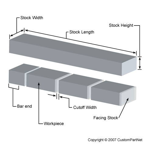

Facing stock
The amount of material that will be removed from the end of a piece of bar stock by a facing or face milling operation, before the next workpiece is cut. The facing stock is used in determining how many workpieces a single piece of bar stock will yield.

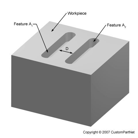

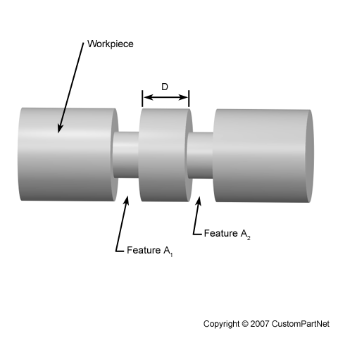

Feature spacing
The distance between two identical features, measured from the end of one feature to the start of the next. If multiple identical features exist at varied spacing, then the average distance between two neighboring features should be used.
Feature spacing (Milling) |
Feature spacing (Turning) |
