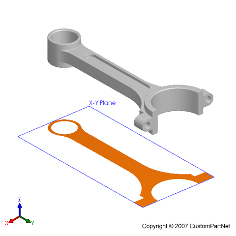

Perimeter
The outer perimeter of the projected area of a part. The perimeter of any projected holes is not included.

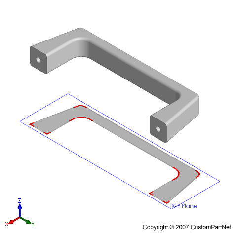

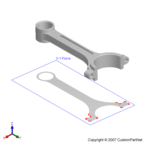

Projected corner
Any corner that occurs on the projected area of a part. The corner does not need to be 90 degrees, but can be any angle or sharp curve. The number of these corners determine the complexity of the die needed to trim to the part.
Handle |
Connecting Rod |

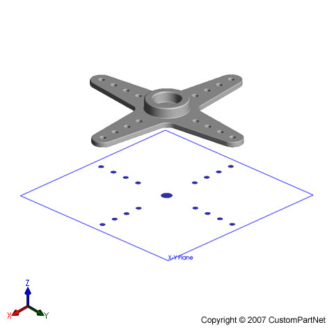

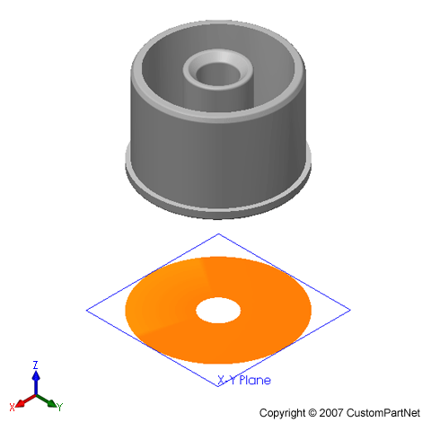

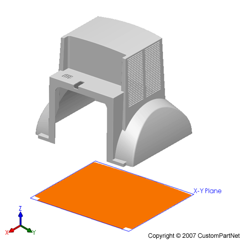

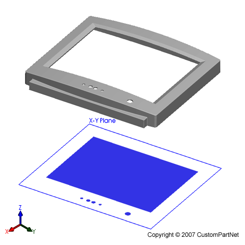

Projected holes
Projected holes are through-holes that project empty space onto the X-Y plane and therefore appear as gaps in the projected area of the part. If the area projected by these holes is very small compared to that of the part, it can be ignored (Servo lever). For holes that project a larger area (Monitor housing), the area can be approximated as a percentage of the X-Y side of the envelope.
Servo Lever (Area can be ignored) |
Front Monitor Housing (54% of envelope) |
