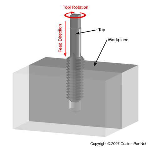

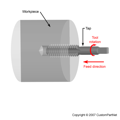

Tapping
An operation in which a tap enters the workpiece axially and cuts internal threads into an existing hole. The existing hole is typically drilled by the required tap drill size that will accommodate the desired tap. On a milling machine, the threads may be cut to a specified depth inside the hole (bottom tap) or the complete depth of a through hole (through tap).
Tapping - Tapping (Milling machine)
Tapping - Tapping (Turning machine)

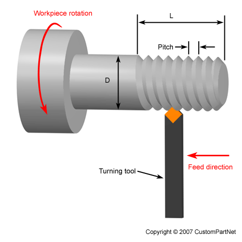

Thread cutting
A turning operation in which a single-point tool, typically with a 60 degree pointed nose, moves axially, along the side of the workpiece, cutting threads into the outer surface. The threads can be cut to a specified length and pitch and may require multiple passes to be formed.
Thread cutting - Thread cutting operation

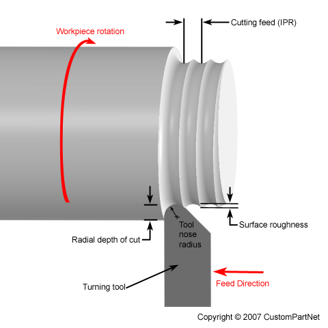

Tool nose radius
In some turning operations, the single-point tool used for finishing has a rounded front corner or "nose". The radius of the tool nose, along with the cutting feed, will determine the surface roughness formed by the finishing operation. For a given cutting feed, a larger nose radius will provide a better finish.
Tool nose radius - Turning operation
Turning operation

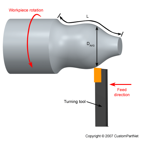

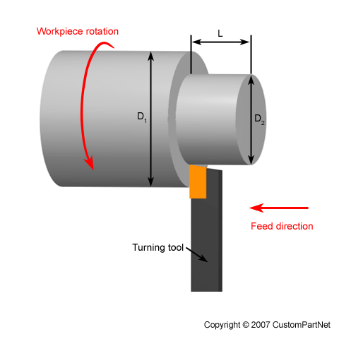

Turning
A turning operation in which a single-point tool moves axially, along the side of the workpiece, removing material to form different features, including steps, tapers, chamfers, and contours. These features are typically machined at a small radial depth of cut and multiple passes are made until the end diameter is reached. For a finish operation, the cutting feed is calculated based on the desired surface roughness and the tool nose radius.
Turning - Step
Step

Turning - Contour
Contour
