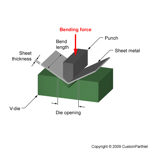

V bending
A sheet metal bending method in which a V-shaped punch presses a piece of sheet metal into the die opening of a V-die. The die opening is a V-shaped groove in the die plate. The width of this opening divided by the sheet thickness is called the die ratio and typically ranges from 6 to 18.

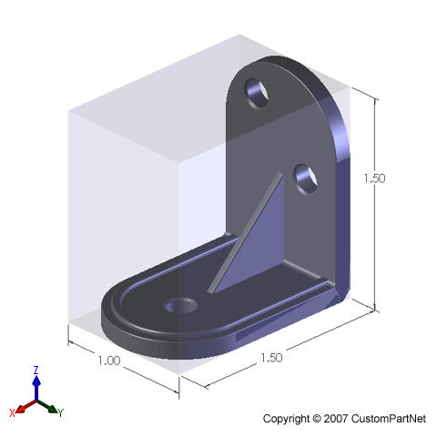

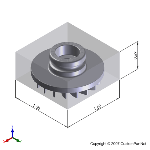

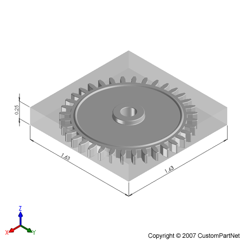

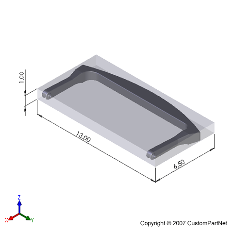

Volume
The amount of space inhabited by a part. The volume of a part can be approximated by the percentage of the envelope volume.
Volume - Stereo Handle (≈5% of envelope)
Stereo Handle
(≈5% of envelope)
Volume - Bracket (≈15% of envelope)
Bracket
(≈15% of envelope)
Volume - Dust Collection Turbine (≈25% envelope)
(≈25% envelope)
Volume - Single Gear (≈35% envelope)
Single Gear
(≈35% envelope)
