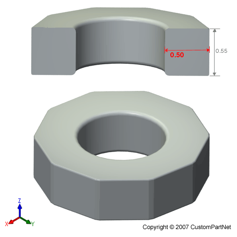

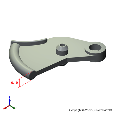

The thickest wall or feature of a part. In molding processes, the maximum wall thickness is used to determine the cooling time because that section will require the most time to cool. In some parts, the thickest section can be easily identified (Trigger), but often several sections should be checked (Button). When measuring the maximum wall thickness of a given section, the smaller dimension is considered the thickness (Knob).
Trigger (t=0.19) |

Knob (t=0.50) |
