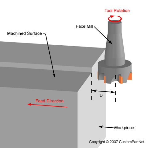

Over-run distance
When machining a feature that is open on one or more sides, the tool may be allowed to move beyond the edge of the workpiece. This over-run distance (D) is measured from the edge of the workpiece to the center of the tool. Therefore, an over-run distance of zero will still allow the full feature to be machined.
Over-run distance - Over-run distance (D)
